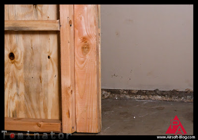

Pictured below is a view of the bottom side of the table, with the two 8' 2x4s mounted. Some of you might notice that I didn't place the top 2x4 flush with the edge of the plywood.
[tr][td][/td][/tr] [tr][td]How to Build a Workbench for Your Airsoft Man Cave
Tom Harris for the Pyramyd Airsoft Blog[/td][/tr]

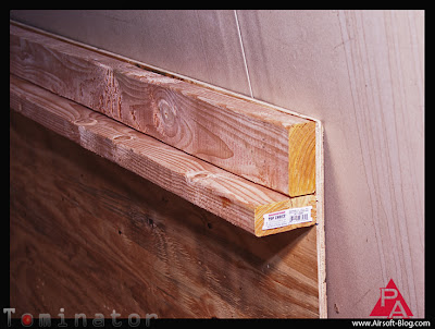

[/table] That's because I wanted to add a reinforced lip to the front of the tabletop so that I could attach things like vices & stuff that need to be able to clamp down on the side of the table.  Some of the stuff I have doesn't open more than 4 inches, so I couldn't just use the framed edge.  So to reinforce the lip, I just added a third 2x4 in the 8-foot length and just laid it flat, using the 2" wood screws again, spaced 8" apart, driven through the top of the table (the side opposite to the one visible in the photo below).

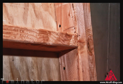

[/table] Here's a shot from different POV so that you can see that I also attached the frame to the lip reinforcement to help keep that lip solid.  Whether or not this was necessary is unknown to me because I'm not a master woodsmith.  But at the time it made sense and I was having fun driving those screws in with my cordless power drill, so I said,  "What the hell? Why not?"

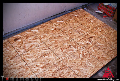

Here's what the frame looks like without the plywood tabletop attached.  I spaced the short 2x4s about 13 inches apart, measuring from the center of each piece.
